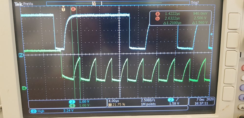

Then I measured and I get that SDA and SCL rise time = 1.2us.
Attached oscilloscope picture.

I2C signals are driven by Open-Drain transistors, and their rise time is given by pullup resistors you are supposed to add externally.
The internal pullup is nominally cca 40kOhm, which may be sufficient only if the load is of low capacitance.

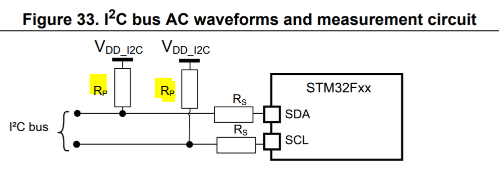

The datasheet measurements are taken with a 4.7kOhm pullup resistor. Guessing you don't have any.

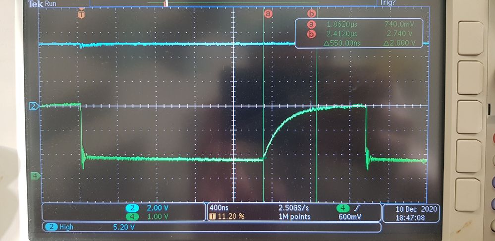

2020-12-10 4:49 AM
Problem didn't solve completely,
I connect another STM32F401RET6 board, and I configured it with the same project only as a slave.
I connect 4.7K pullup between master board to slave board.
the rise time is now 550ns.
Please advise.
2020-12-10 6:20 AM
(ignore)
2020-12-10 6:37 AM
The risetime is simply given by RC constant. 550ns/4k7=cca 110pF, not an entirely unreasonable value, especially if you connect two boards with lengthy cables.
