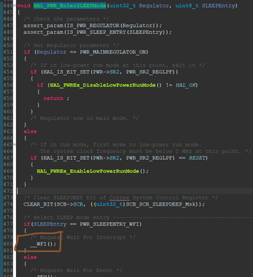

@Yiran Tian I am also facing a similar issue like this. For TouchGFX application, I am trying to implement sleep mode, HAL_SuspendTick() is working fine (cross verified by using HAL_Delay()after the suspendTick() , not working as time base which is responsible for producing HAL_Delay() is disabled) after the HAL_SuspendTick() function call, the control is expected to stop at _WFI, present inside the HAL_PWREnableSLEEPMode()'s function definition, but it is not stopping and waiting for interrupt. Kindly help me to solve my issue.
Thank You,
