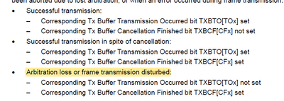

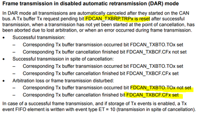

In the reference manual I see an other possible solution for this problem, but I can't get it to work:
I check TXBTO and TXBFC for a lost of the arbitration contest like this:
if (TXBFC & ~TXBTO)
...The problem with this is, that I now count to much lost of arbitration contest. Perhaps I need to trigger TXBRP from 1 to 0? I have not found a way (Interrupt) for that.
2025-04-02 1:48 AM
I don't think this is an efficient way as it's not exclusively to signal the loss of the arbitration but also an issue in transmission.
