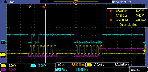

I'm attaching a screenshot of what I see on the scope. (yellow: sclk, blue: read command register 31, purple: output from ADC).
MOSI transmits properly to the
http://www.ti.com/product/ADS7870
(the din pin receives read command), but there is no response coming from the ADC dout pin.I would really appreciate any help on this.

Don't you find disturbing that your waveform doesn't match the read waveform in the ADS7870 datasheet (Fig.18)?

It is the same waveform. Data is latched in the rising edge as in the datasheet.
Here is the waveform I obtain when using the ADS7870 with ATMEGA8 (where everything works properly).2014-01-16 4:17 AM
> It is the same waveform. No, it is not. The datasheet figure shows the command LSB first, yours is MSB first. Meantime, reading the datasheet revealed, that it features both, and MSB first is the default. A cunning way to mislead the casual reader... Also, you don't show the /CS signal. The description in the datasheet indicates, that it's important to have a low-going transition on /CS before start of communication. There is an alternative procedure described on the bottom of page 17. > Data is latched in the rising edge as in the datasheet. But that's only if the RISE/FALL pin is tied to 1. How is it in your circuit?> Here is the waveform I obtain when using the ADS7870 with ATMEGA8 (where everything works properly).
Then what are the differences between these two cases? JW2014-01-16 5:03 AM
One more thing - the waveform you presented above exhibits significant ringing on the edges. If these are real and not only artifacts of improper measurement setup, they may be seen by the SPI receiver in the ADC as false clocks and throw the receiver out of sync.
