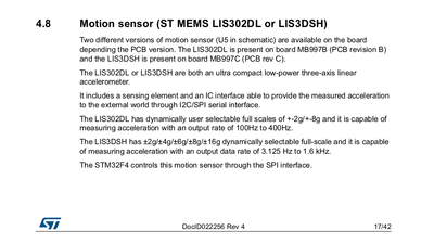

I’m currently working on a bare-metal project using the STM32F4 Discovery (Disc1) board and developing my code purely with CMSIS header files (no HAL or CubeMX).
I wanted to check if this board has any onboard MEMS sensors (like accelerometer or gyroscope) — similar to what some older STM32 Discovery boards include.

To check what are the MEMS available on your board, you can refer to the schematic pack and the bill of material of your board (check the revision on your board). Those ressources are available here. For the examples you can have a look at this demonstration example (it is based on HAL). I suggest you to follow it and referring also to the Datasheet of the MEMS you can develop your own code based on the register access method that you are using (there is no register level official examples).
PS: on the DK board you are using there is a MEMS 3-axis accelerometer connected using SPI to the MCU). You can find the exact reference on the readme file of the example I’ve attached.

A quote from the user manual :
So, yes.
