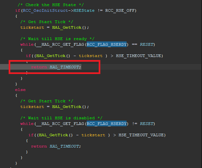

@TDK No longer stuck (in that place at least), as stated SCB->VTOR is 0x0800 0000 and HAL_Init is completed along with timer isr's functioning.
Now comes an issue with custom board timeout waiting for RCC_FLAG_HSERDY in SystemClock_Config()->HAL_RCC_OscConfig().
Timer ticks are incrementing but RCC_FLAG_HSERDY never == RESET.
Will try increasing timeout as a start, but looks like something may be different for the RCC config on custom board vs dev board.
Looking at the osc HW setup now...
EDIT: This one is solved, EE has an XTAL on board, I switched to ceramic resonator on PF0/1 and all is well.
