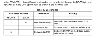

what is state of boot0 pin , gnd ?
(0x1ffffxxx looks like jump to system/bootloader...)

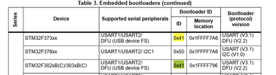

@TDK - Thank you for the information. I have been looking through 2606 document and became a bit confused. The only reference to the STM32F3xxx in Table 3 states that bootloader ID is 0x50 @ 0x1FFF F796:
Yet, reading the flash at that address, reveals 0x41 as the ID:
which from the table relates to different STM32 devices than the device that is connected:
I am supposing that the flash doesn't lie, but it seems inconsistent to the documentation.
EDIT: Update: the 0x41 is correct after opening my eyes a bit:
It seems I am most interested in the nBOOT1 option byte, as I have electrical control of BOOT0.

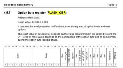

From RM0316 for STM32F303 it states that the Option Byte register (FLASH_OBR) is located at offset 0x1C. Offset from where I cannot seem to figure out:

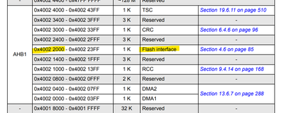

The offset is from 0x40022000 as seen here:

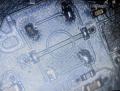

It turned out to be a HW issue that @AScha.3  made me investigate further. The switch on the board for BOOT0 high/low was mounted incorrectly and caused BOOT0 to be logic 1 for this particular board.
There was no other electrical way to get BOOT0 to logic 0 other than removing the BOOT0 selection switch from the PCB:
Bye bye switchie:
Removed boot selection switch from the PCB and all is well. I was thinking this was way worse than it was (clock chasing, etc.).
