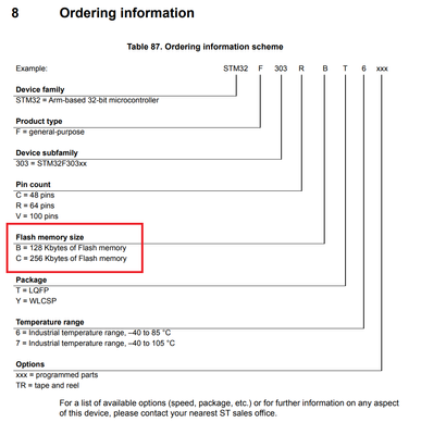

This information is provided in the product datasheet / Section 8 Ordering information:

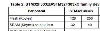

and in Table 2. STM32F303xB/STM32F303xC:
The difference is in the Flash and RAM size . I don't see other differences. So if you have a hex file working fine on CBT6 that should work on CCT6.
