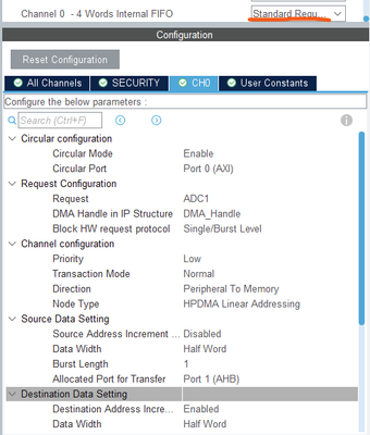

 But I did not configure a linked list in CubeMX:
Is my HAL_ADC_MspInit() function incorrect?
