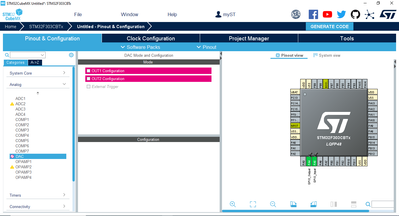

2023-09-25 9:16 AM
Hello @DRH
As you can see in the screenshot, you can even configure the OUT 1 in CubeMX when you use PA4 as an output or input mode or alternate function.
Best regards.

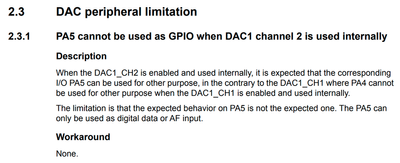

2023-09-25 9:37 AM
The (very poorly worded) errata applies to your chip, but it suggests only PA5 is affected.
"STM32F303xx silicon limitations" certainly applies to the STM32F303CBT6.

2023-09-25 10:00 AM
PA4 can't be used for other purpose when when the DAC1_CH1 is enabled and used internally. PA5 is affected by the errata. Then both of them can't be used.
