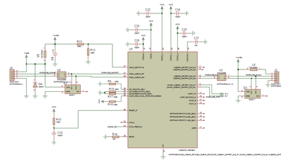

I have an stm32f303cbt6 design (see image below) connected to an hub(USB2533) and an adum for isolation, i'm trying to run a USB device CDC example by creating a new project in the Stm32CubeIDE using device tool configuration.
I selected :
- RTC : HSE Bypass clock source (24Mhz)
- SYS : Serial wire debug
- USB : fs device
- Middleware : USB device CDC
When i build and i compil to my board, windows doesn't recognise it, can you help me with that ?
(i tried also to put the connect_usb pin to 3.3 V, i got same thing)
Thanks.

I don't have windows message.
I got this in USBTree (the hub has 3 downstream), it seems like the hub is detected but not the device (stm32).

Is the device detected without the Hub ?
If you don't get any messages, and nothing appears in Device Manager, then the PC is not even seeing that anything has been plugged it.
Are you sure that you are using a good data cable - not just a charging cable?

I can't plug the device alone, the design is soldered on the PCB.
Yes, i'm using usual cables. The actual fw running inside is using USB Vendor Specific and it's well detected but when i try the example i describe, it's not running.

So the hub is part of your PCB?
Would be helpful to show a block diagram...
2024-11-18 3:12 AM
This is the hub part.
