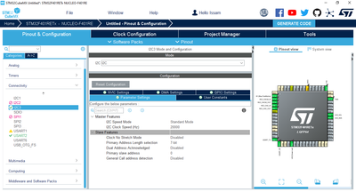

Hello @DJ1
Usually, when you start the configuration of your ADC values using CubeMX, you find the default value of the I2C clock speed(Hz) is equal to 100000.
You can change it manually to any value you want(20000) in your case.
If you are programming using direct register acces, you have juste to write 400 to the CCR register.
Best regards.
