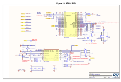

It recommends the NUCLEO-F103RB - you can download its schematics from:
https://www.st.com/en/evaluation-tools/nucleo-f103rb.html

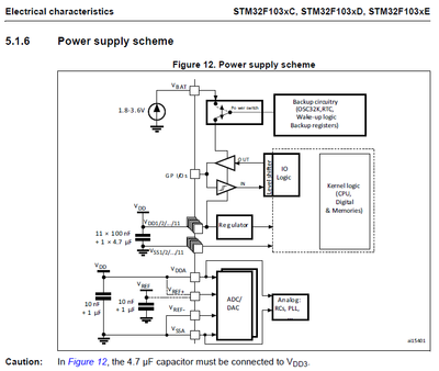

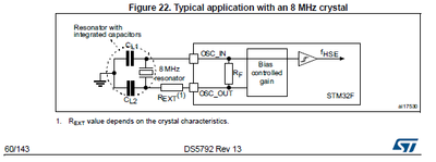

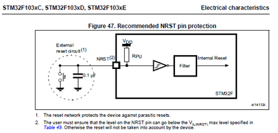

The Data Sheet includes useful info like power supply, crystal, reset, etc:

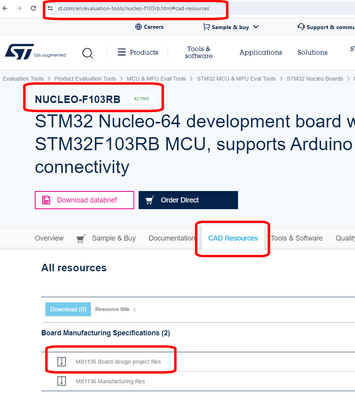

@murali - "I tried but I could not download the schematic"
The schematic is included in the User Manual for the Nucleo board, and can be downloaded separately as "design files" under "CAD Resources":

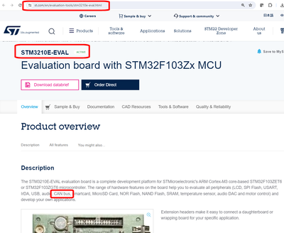

2024-01-11 3:33 AM
@murali - "I used the IC specially for CAN protocol but I don't know for connection"
Then look at the STM3210E-EVAL - that has CAN:
again, schematics will be on the 'CAD Resources' tab
