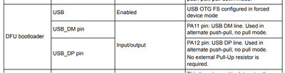

The system USB DFU bootloader is only available on the FS USB.

Wow... Absolutely an amazing catch. Yeah I didn't realize that there were 2 distinct PHY output pins for USB OTG Full Speed and USB High Speed.
I guess my next step is to write some sort of alternative DFU compatible state for my device that enables the use of the USB HS PHY because of the fact that I didn't include a second USB port for DFU mode :p
