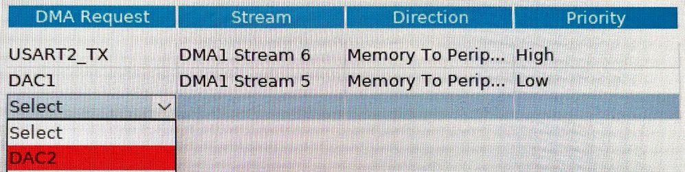

I use STM32F407 Discovery board to generate analog signals using DAC with DMA transfer. The goal is to use both DAC channels to have two signals generated simultaneously. However, I cannot enable the DMA request for the second channel.
After analyzing previous posts, I understood that I need to change the settings on the low level and deal with registers.

i see no problem on F407 :
-> go with mouse to the red marked ... system should tell you, what you doing wrong.

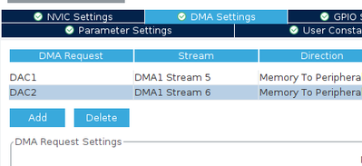

2024-01-11 3:33 AM
Thank you very much! It was conflicting wuth USART... no need to go deep woods :)
2024-01-11 3:40 AM
I just had a short look at the ref manual, to me it seems that you could solve this with 1 DMA channel only, when you choose one of the dual DAC data registers as peripheral target register for the DMA.
