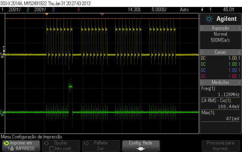

I trying to use the SPI and I am using uVision Keil. The clock appear with a latency that I can take off by removingwhile (SPI_I2S_GetFlagStatus(SPI1, SPI_I2S_FLAG_RXNE) == RESET);
But when I do that I read wrong the data. The 3 last bytes is what I have to read from ADS1 The first byte is the command for read the conversion (ADC). Here's the code:/* SPI1 configuration ------------------------------------------------------*/

And here's the latency. If I use the SPI_BaudRatePrescaler with 128 the latency go away. But its too slow.

Perhaps if you want it to sustain a stream you need to send bytes when TXE is set, and read when RXNE is set, instead of serializing the operation so it sequences in the least efficient manner?

Thanks for the answer Clive.
What do you mean with''instead of serializing the operation so it sequences in the least efficient manner?'' I am sending a byte when RXNE is set. or not? I put the TXE nothing changes.while (SPI_I2S_GetFlagStatus(SPI1, SPI_I2S_FLAG_TXE) == RESET);

Serializing, ie doing ONE thing at a time and precluding advancement to the next state until the perceived completion of the current state, ignoring the fact that there is in fact a buffer, and the operations are not mutually exclusive.
i = 0;
j = 0;
while(j < 4)
if ((SPI_I2S_GetFlagStatus(SPI1, SPI_I2S_FLAG_TXE) != RESET) && (i < 4))
SPI_I2S_SendData(SPI1, TxData[i++]);
if (SPI_I2S_GetFlagStatus(SPI1, SPI_I2S_FLAG_RXNE) != RESET)
RxData[j++] = SPI_I2S_ReceiveData(SPI1);

Thank you, it worked.
