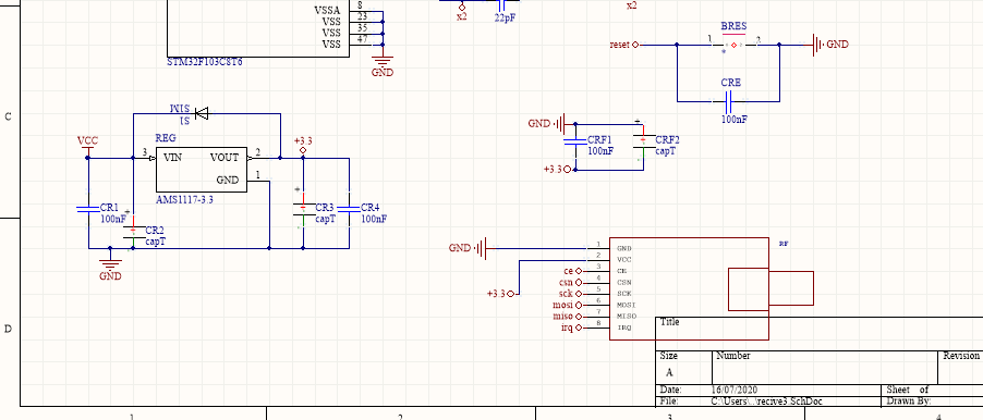

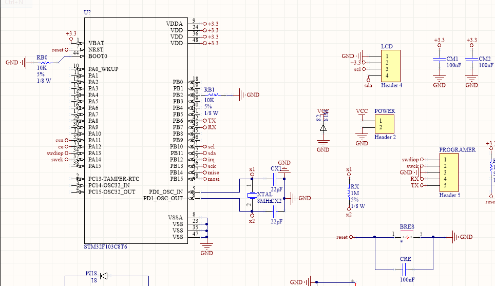

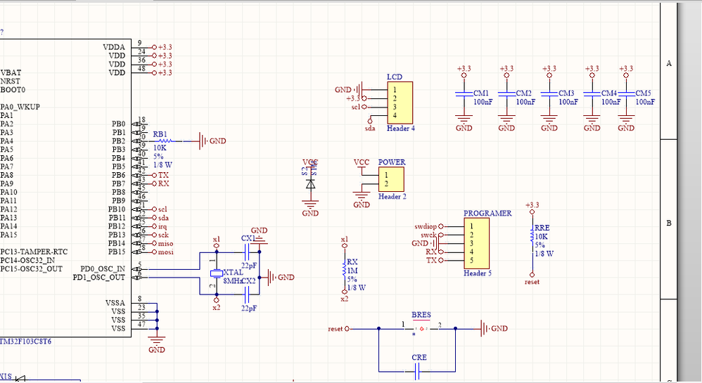

Hi, I am trying to make a circuit with stm32f103c8t6 and a nrf24l0+. I attach my schematic if pcb layout needed tell me to upload that. One of the circuit work good ( the send one) the other one which is identical does not.
after soldering I did check if any short cuts happen there was not any short cut, everything was good but after I power it up and connect the stlink_v2 and programming it ( it did it just fine) I tried to work with but it act abnormal
(especially timings) after I check for vcc and gnd pin I get 124 ohm or lower impedance on them I did it with other PCBs too but same thing happens.
My regulator , regulate voltage on 3.3 volt.
st_link_v2 work I could even program this 124 ohm stm32f103c8t6.
In other PCBs impedance reduce to 20 ohm.
The files are for altium designer .
send works but revive act abnormal .

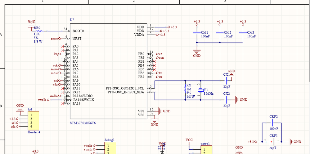

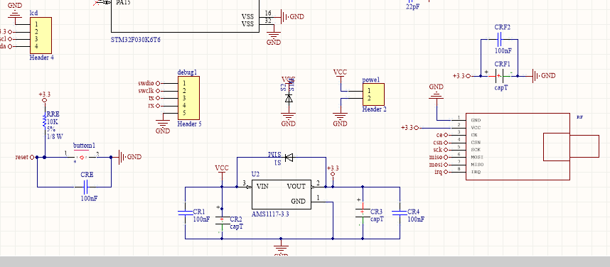

Hi, again I did the design for stm32f030k6t6 in this case after some time it hang and it does not work after several programing I could not even erase it .
sth should wrong with my design but I could not figure it out I attach my schematic.
