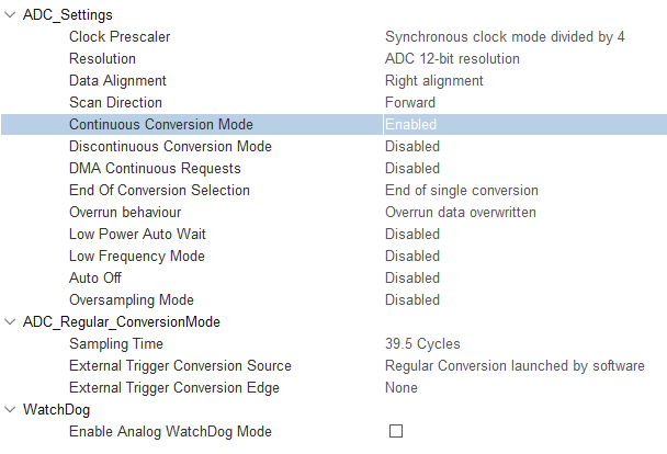

I am trying to read 2 channel ADC with STM32L011F4.
My ADC and DMA settings in cubemx are as follows

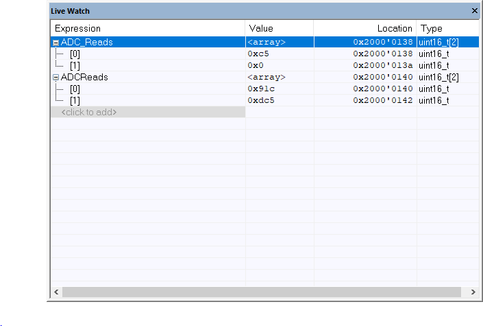

my problem is that the DMA only returns the low 8 bit of the last channel.
uint16_t ADC_Reads[2] = {0};
while (1)
HAL_ADC_Start_DMA(&hadc,(uint32_t *)ADC_Reads,2);
HAL_Delay(1000);
}When I write the following code in the DMA IRQ handler, I can read the values.

}EWARM live watch screen looks like below

Lots of people had issues wth this, including me.
Try this out:
HAL_ADC_Start_DMA(&hadc,(uint32_t *)ADC_Reads, sizeof(ADC_Reads)/sizeof(ADC_Reads[0]));
or
HAL_ADC_Start_DMA(&hadc,(uint16_t *)ADC_Reads, sizeof(ADC_Reads)/sizeof(ADC_Reads[0]));
2022-05-06 12:36 AM
it didn't work result is same
