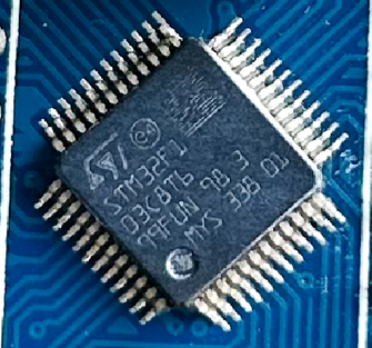

Unfortunately, our logo on an MCU does not prove at all that it is an original. STM32F103C8T6 in particular have been counterfeited on a large scale for several years, including the logo.
In cases where you cannot be completely sure that the seller is selling original goods (Aliexress, Ebay, etc.), it is advisable to check this with a test programme. You can also find tips on this here in the community, e.g. here or there.
Regards
/Peter
2025-01-28 8:03 AM
The MCU that the manufacturer used looks like this one from the link you send, is this the one you said is counterfeit?
2025-01-28 8:06 AM
No that's why I tried to do this new PCB.
2025-01-28 8:08 AM
Yes

As I already mentioned: as long as you can't trace the supply chain in detail, nobody can say for sure, only one of the tests mentioned can clarify this.
