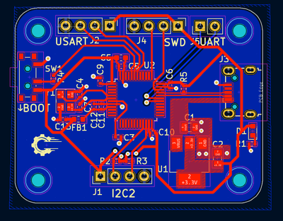

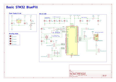

I found this schematic and layout with a stm32f103c8t6. I ordered it and wanted to programm it.

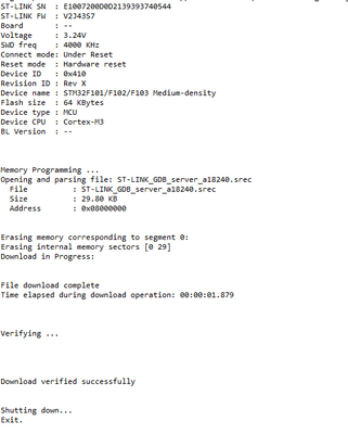

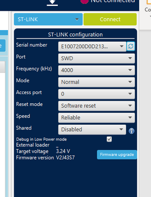

With stm32cubeprogrammer I detect the stm32 no problem via ST-LINK.
Same with stm32cubeide I can download successfully the code.

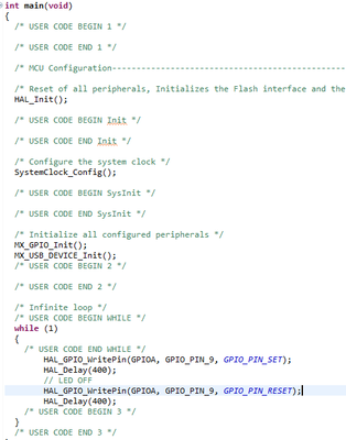

But now the problem is that eventhough the code is downloaded successfully the simple program to blink a pin to which I attach a diode is not working and I don’t see why.

If you see any problem in the design please tell me.

2025-01-28 4:52 AM
Which LED you want to flash?
I don't see any LED on PA9 that you are trying to control with your code?

2025-01-28 5:02 AM
It is a LED connected to the pin A9 and to GND, i checked that the diode was working when connected to +3.3V to GND it is the case so the diode is not the problem.
2025-01-28 5:02 AM
Please see How to insert source code - not as screenshots.
@JTAPIE wrote:the simple program to blink a pin to which I attach a diode is not working
Please show how you are attaching the LED.
"Not working" tells us little: does the LED not light at all? stay on permanently? burst into flames?
@JTAPIE wrote:Any idea of what I could look for or resources ?
Use the debugger to see what the code is actually doing.
Certainly, get the LED working before moving on to advanced stuff like USB!

/* USER CODE BEGIN Header */
* @file : main.c
* @brief : Main program body
* @attention
* Copyright (c) 2025 STMicroelectronics.
* All rights reserved.
* This software is licensed under terms that can be found in the LICENSE file
* in the root directory of this software component.
* If no LICENSE file comes with this software, it is provided AS-IS.
/* USER CODE END Header */
#include "main.h"
#include "usb_device.h"
/* USER CODE END Includes */
/* USER CODE BEGIN PTD */
/* USER CODE END PTD */
/* USER CODE BEGIN PD */
/* USER CODE END PD */
/* USER CODE BEGIN PM */
/* USER CODE END PM */
/* USER CODE BEGIN PV */
/* USER CODE END PV */
/* USER CODE BEGIN PFP */
/* USER CODE END PFP */
/* USER CODE BEGIN 0 */
/* USER CODE END 0 */
* @retval int
int main(void)
/* USER CODE BEGIN 1 */
/* USER CODE END 1 */
HAL_Init();
/* USER CODE BEGIN Init */
/* USER CODE END Init */
SystemClock_Config();
/* USER CODE BEGIN SysInit */
/* USER CODE END SysInit */
MX_GPIO_Init();
MX_USB_DEVICE_Init();
/* USER CODE BEGIN 2 */
/* USER CODE END 2 */
/* Infinite loop */
/* USER CODE BEGIN WHILE */
while (1)
/* USER CODE END WHILE */
HAL_GPIO_WritePin(GPIOA, GPIO_PIN_9, GPIO_PIN_SET);
HAL_Delay(400);
// LED OFF
HAL_GPIO_WritePin(GPIOA, GPIO_PIN_9, GPIO_PIN_RESET);
HAL_Delay(400);
/* USER CODE BEGIN 3 */
/* USER CODE END 3 */
* @retval None
void SystemClock_Config(void)
RCC_PeriphCLKInitTypeDef PeriphClkInit = {0};
RCC_OscInitStruct.HSEPredivValue = RCC_HSE_PREDIV_DIV1;
RCC_OscInitStruct.HSIState = RCC_HSI_ON;
RCC_OscInitStruct.PLL.PLLMUL = RCC_PLL_MUL3;
Error_Handler();
RCC_ClkInitStruct.SYSCLKSource = RCC_SYSCLKSOURCE_HSE;
RCC_ClkInitStruct.APB2CLKDivider = RCC_HCLK_DIV1;
if (HAL_RCC_ClockConfig(&RCC_ClkInitStruct, FLASH_LATENCY_0) != HAL_OK)
Error_Handler();
PeriphClkInit.PeriphClockSelection = RCC_PERIPHCLK_USB;
PeriphClkInit.UsbClockSelection = RCC_USBCLKSOURCE_PLL;
Error_Handler();
* @PAram None
* @retval None
/* GPIO Ports Clock Enable */
__HAL_RCC_GPIOD_CLK_ENABLE();
__HAL_RCC_GPIOA_CLK_ENABLE();
/*Configure GPIO pin Output Level */
/*Configure GPIO pin : PA9 */
GPIO_InitStruct.Pin = GPIO_PIN_9;
/* USER CODE BEGIN MX_GPIO_Init_2 */
/* USER CODE END MX_GPIO_Init_2 */
/* USER CODE BEGIN 4 */
/* USER CODE END 4 */
* @retval None
void Error_Handler(void)
__disable_irq();
while (1)
#ifdef USE_FULL_ASSERT
* @PAram file: pointer to the source file name
* @PAram line: assert_param error line source number
* @retval None
/* USER CODE BEGIN 6 */
ex: printf("Wrong parameters value: file %s on line %d\r\n", file, line) */
/* USER CODE END 6 */
#endif /* USE_FULL_ASSERT */
