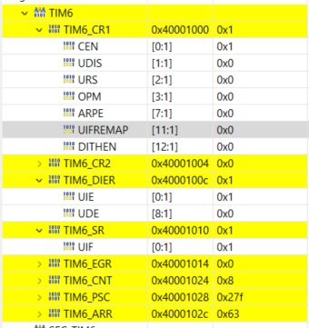

I mentioned in my previous comment that the TIM6 configuration is correct.
If I don't use the HAL_Delay outside my threads, the handler of TIM6 triggers and works correctly. But the problem is that when I add the HAL_Delay outside ThreadX tasks, the code gets stuck in this construction and prevents the TIM6 handler trigger.
Below is TIM6's config:
