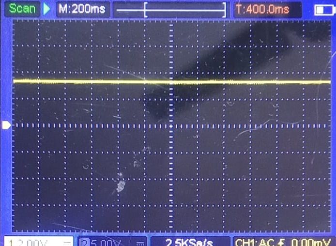

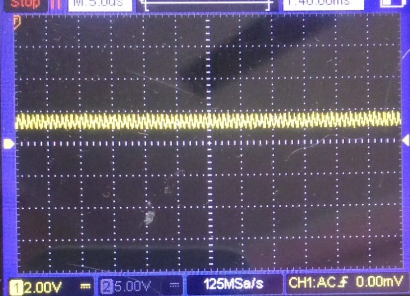

SWD works fine. I am able to download the firmware. But mcu remains in reset mode . MCU doesn't excute the program. 3.3V supply doesn't drop during connection. DFU mode is detected by the PC .But MCU resets when I try to connect with cube programmer. I have attached VCAP voltage waveform , and 3.3V line wave form for refferance. 3.3V line stays stable during entire operation. MCU connects with cube programmer in dfu mode if I apply a little bit of heat over the mcu and able to download the firmware. MCU remains connected as long as it is warm . Connection disconnectes as soon as mcu cools down. May be mcu's internal voltage regulator not working properly due to some reason.
3.3V waveform (Completely stable...no disturbances observed)
VCAP waveform

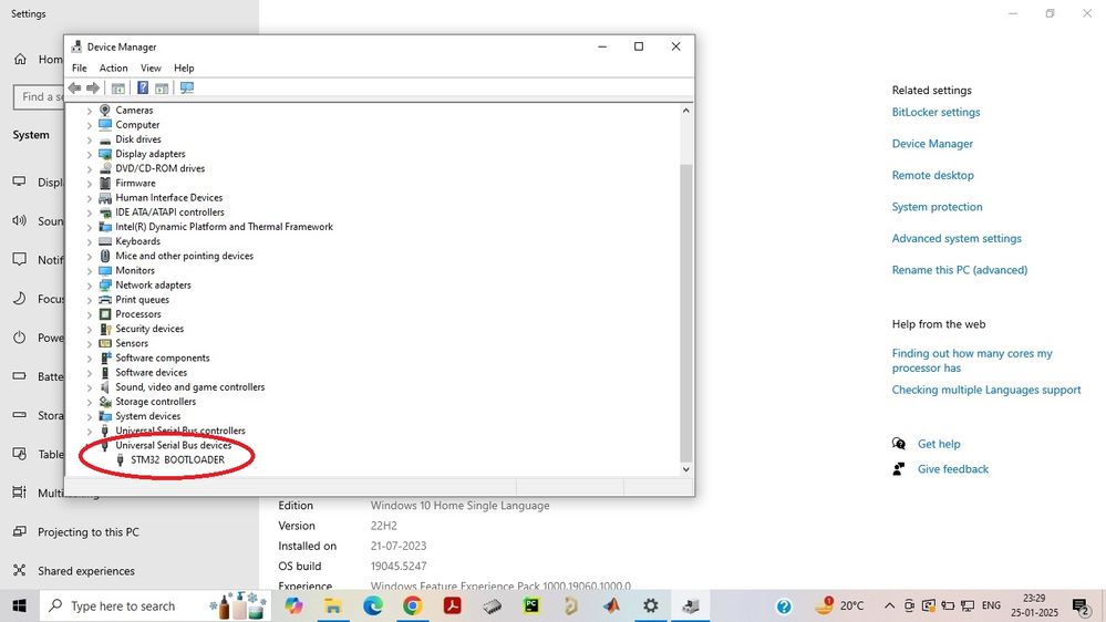

May be.But where the short is, can't figure out. Can't find any trace of short with measurement. Everything looks ok. The board connects with PC . Windows shows "ST BOOTLOADER " in deice manager list . Where the issue is comming from dont' know. Anyway I am still trying to figure out . Thanks for your reply.
