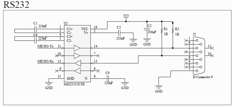

thanks for quick reply!
i using max232 in my hardware like the attachment and using 10kO resistors on RX and TX lines for decrease noises like the attachment,2015-05-25 11:41 AM

The MAX232 device is rated for 5V operation, not 3.0-3.3V
I m using MAX3232. HSE_VALUE is 12MHz , i set PCLK2 equal to HCLK and HCLK = SYSCLK that is PLLCLK = HSE * 6 , so my PCLK2 is equal to 72 MHzWe’re moving the ST Community to a new platform to give you a better and more reliable community experience.
