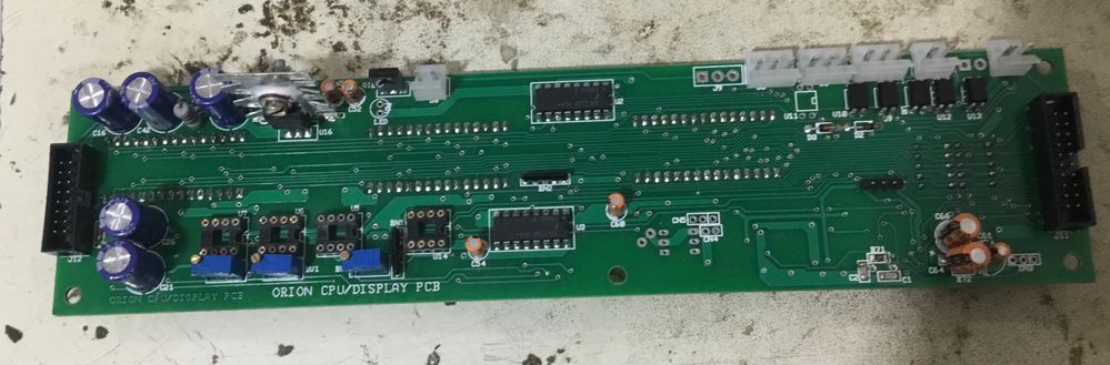

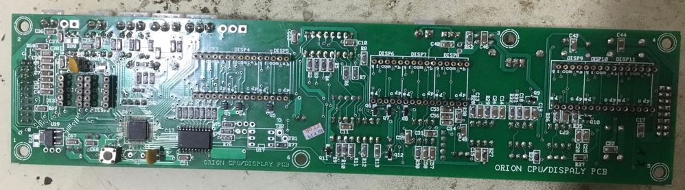

It is a custom board

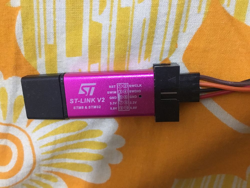

Show how this is wired to the ST-LINK you're using.
Perhaps use STM32 Cube Programmer, rather than ST-LINK Utilities, it will show the measured voltage
CN2 left-of-right, STM32 component side
GND, SWCLK, SWDIO, 3V3
CN2 pin side
3V3, SWDIO, SWCLK, GND
The 3V3 needs to go to pin 1 on the ST-LINK 20-pin header, you need a GND,
SWCLK to pin 9, SWDIO to pin 7
Part number unreadable in pictures. Show U1 tight, large and in-focus
