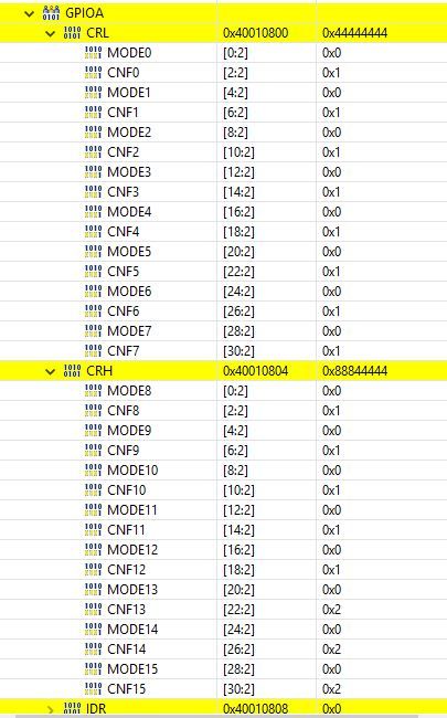

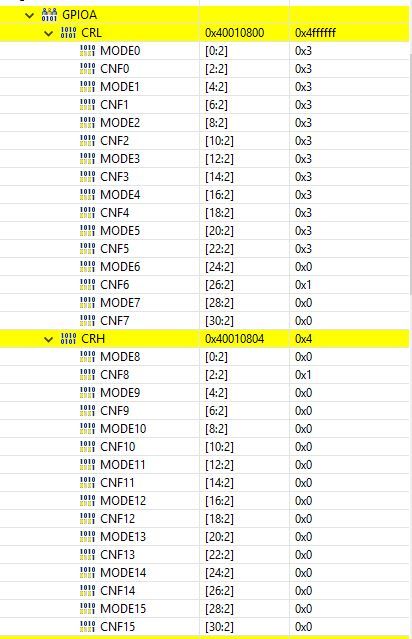

A piece of code from STM32CubeMX v4.0 and latest F1 drivers generated for STM32VLDiscovery (the button is pulled-down by external resistor):
{LL_GPIO_InitTypeDef GPIO_InitStruct;
/* GPIO Ports Clock Enable */
LL_APB2_GRP1_EnableClock(LL_APB2_GRP1_PERIPH_GPIOC); LL_APB2_GRP1_EnableClock(LL_APB2_GRP1_PERIPH_GPIOD); LL_APB2_GRP1_EnableClock(LL_APB2_GRP1_PERIPH_GPIOA);GPIO_InitStruct.Pin = LL_GPIO_PIN_0;
GPIO_InitStruct.Mode = LL_GPIO_MODE_FLOATING; LL_GPIO_Init(GPIOA, &GPIO_InitStruct);}
and the results from the Keil debugger:
So commented the line below to prove that there is only one line of code used for GPIOA initialization:
// LL_GPIO_Init(GPIOA, &GPIO_InitStruct);
and got as expected (the default settings for GPIOA)
It seems that the LL_GPIO_Init gives messy config on more than one pin. Am I wrong?

GPIO_InitStruct.Mode = LL_GPIO_MODE_OUTPUT;GPIO_InitStruct.Speed = LL_GPIO_SPEED_FREQ_HIGH;GPIO_InitStruct.OutputType = LL_GPIO_OUTPUT_PUSHPULL;LL_GPIO_Init(GPIOA, &GPIO_InitStruct);As expected, before the LL_GPIO_StructInit(GPIOA) the settings of GPIOA looked like this
To my surprise the LL_GPIO_StructInit(GPIOA) did this to the actual settings of GPIOA
I didn't expect any change at all, I thought it would only fill the structure with the defaults, not actually changing anything in the uC. No doubt I (a hobbyist too) am doing things wrong but for me the docs are quite confusing.
