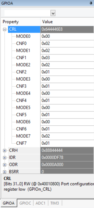

A piece of code from STM32CubeMX v4.0 and latest F1 drivers generated for STM32VLDiscovery (the button is pulled-down by external resistor):
{LL_GPIO_InitTypeDef GPIO_InitStruct;
/* GPIO Ports Clock Enable */
LL_APB2_GRP1_EnableClock(LL_APB2_GRP1_PERIPH_GPIOC); LL_APB2_GRP1_EnableClock(LL_APB2_GRP1_PERIPH_GPIOD); LL_APB2_GRP1_EnableClock(LL_APB2_GRP1_PERIPH_GPIOA);GPIO_InitStruct.Pin = LL_GPIO_PIN_0;
GPIO_InitStruct.Mode = LL_GPIO_MODE_FLOATING; LL_GPIO_Init(GPIOA, &GPIO_InitStruct);}
and the results from the Keil debugger:

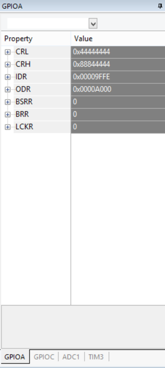

So commented the line below to prove that there is only one line of code used for GPIOA initialization:
// LL_GPIO_Init(GPIOA, &GPIO_InitStruct);
and got as expected (the default settings for GPIOA)
It seems that the LL_GPIO_Init gives messy config on more than one pin. Am I wrong?

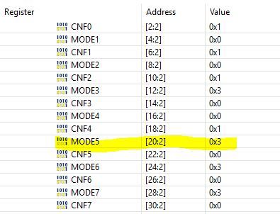

I think I have found something similar. When I do this:
GPIO_InitStruct.Pin = LL_GPIO_PIN_4|LL_GPIO_PIN_5; GPIO_InitStruct.Mode = LL_GPIO_MODE_FLOATING; LL_GPIO_Init(GPIOA, &GPIO_InitStruct);GPIO_InitStruct.Pin = LL_GPIO_PIN_3|LL_GPIO_PIN_6|LL_GPIO_PIN_7;
GPIO_InitStruct.Mode = LL_GPIO_MODE_OUTPUT; GPIO_InitStruct.Speed = LL_GPIO_SPEED_FREQ_HIGH; GPIO_InitStruct.OutputType = LL_GPIO_OUTPUT_PUSHPULL; LL_GPIO_Init(GPIOA, &GPIO_InitStruct); //******************************************************************the result looks like this:
The second LL_GPIO_Init reconfigures GPIO_PIN_5 from an input to an output!

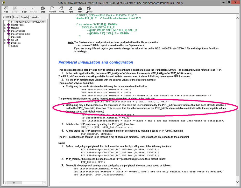

You're contradicting yourself within two consecutive lines:
unfortunately in this case, rather than making SPL great again,
that's the risk with any library.
So what's that great about SPL, exactly?
PS. To be fair, SPL *did* come with *some* documentation which *did* contain a guideline about initializing the init structs - whereas Cube contains only the doxygen autovomit. But then nobody read the documentation back then, too, and this problem was a regular here. It sort of went away with most people relying on CubeMX generating their init stuff, which may be correct - I don't know, I can't run CubeMX as I refuse install Java and ST refuses to attach the JVM to their javoids.
