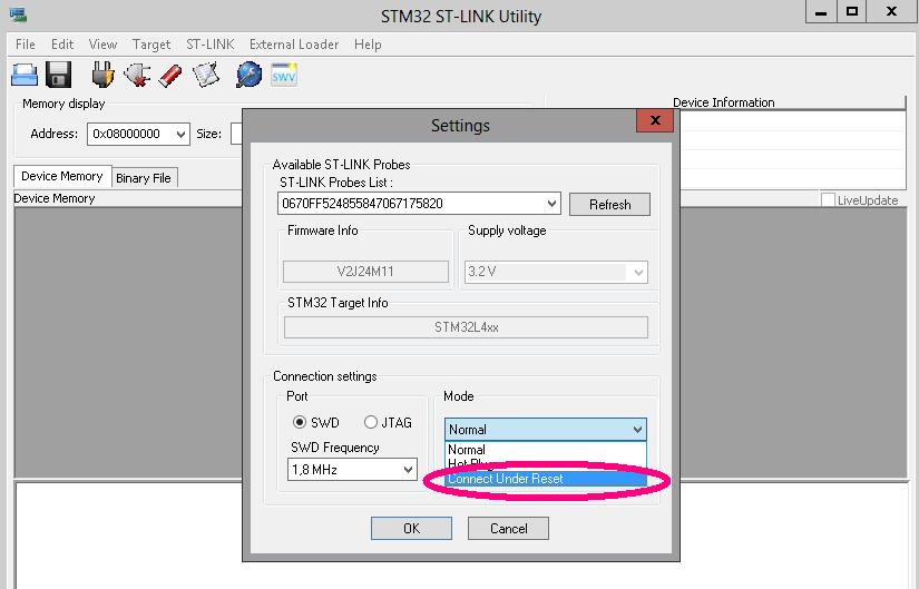

You mean programming through SWD, from STLink or similar?
You'll need to use the ''connect under reset'' option for programming,
- or equivalent in your programming environment - and connect the respective STLink line to NRST.

I don't Cube so I don't know (I don't even know what pin stacking means). But you can simply set it as UART2_TX, and when programming, during reset it will function as SWCLK (that's why you need the connect under reset for programming).
You won't be able to debug through SWD, though.
