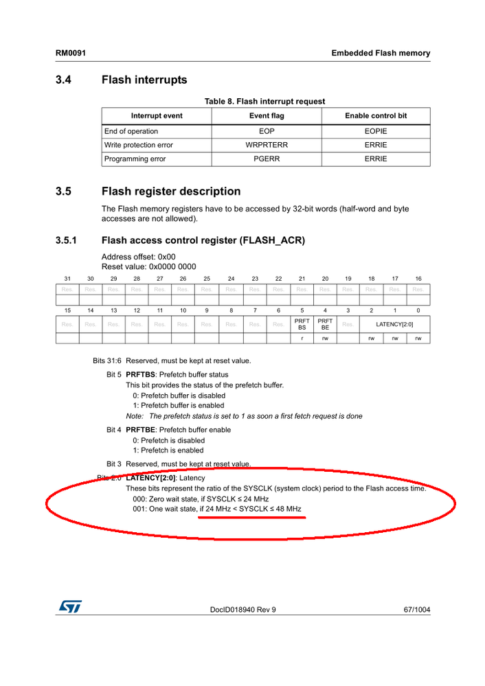

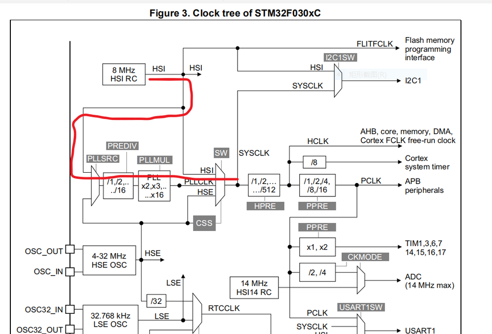

In the clock tree in the screenshot I took earlier, HSI is directly used as PLLSRC. There is no frequency divider in the middle of this.I didn't understand how this frequency divider 2 came out?
Question 2:
The LATENCY of the FLASH_ACR register you mentioned, I refer to the description in the manual, and I don't really understand its meaning. Is it necessary to set it to 1 when the system clock is above 24M, what does this value mean? I used to use stm32f030c8 as the default value (0), But there was no problem.

2020-04-19 2:26 AM
Now I am just as confused as you.
The description of the RCC_CFGR register in the reference manual says,
Bit 16 PLLSRC: PLL entry clock source
Set and cleared by software to select PLL clock source. This bit can be written only when PLL
is disabled.
0: HSI/2 selected as PLL input clock
1: HSE/PREDIV selected as PLL input clock
that's why I have assumed that the frequency is divided by 2.

Q1: As berendi said, if you select PLLSRC=0, input to PLL is HSI/2 - the PREDIV in the diagram in your screenshot is forced to 2.
Q2: The internal FLASH is too slow to run at 48MHz, so accesses to it have to be slowed down by the FLASH controller, that's where the latency setting comes into play:
FLASH->ACR = (1 << FLASH_ACR_LATENCY_Pos) | FLASH_ACR_PRFTBE; // 1 cycle latency, + switch on prefetch
