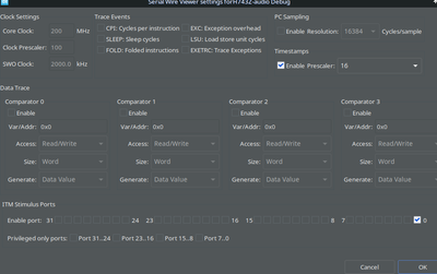

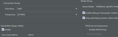

enable in debug SWV: (cpu core clock has to be the real clock value ! ! here 200MHz )
set itm0 , when debug started, wait at main, in SWV settings:
+ "start" with the red button
-> then run program and get the messages you send:
btw
sometimes its not working on the first run, end debug, start it again, red button again...
funny: if its working, its always working, also after mod code, compile, debug...no need to start it again... :)

You have to disable PC Sampling.
I posted it here
PC Sampling is only for the SWV Statistical Profiling feature. I don't think you can have SWV ITM debugs and Statistical Profiling running concurrently.
In fact I now find Statistical Profiling is very hard to get working, but I used it successfully a few years ago (earlier version of Cube than my 1.14.1).
BTW I froze Cube at 1.14.1 because later versions don't fix anything, and mostly broke the debugger.

The general reliability issues remain, however, and AFAICT disabling PC Sampling is now a requirement for the SWV ITM debug console to work. I can reproduce this across several targets and operating systems.
