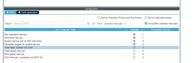

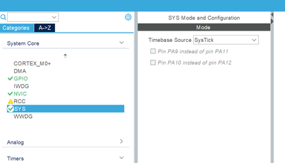

I am using a STM32C031G6U6 and I would appreciate some clarification regarding HAL timebase and SysTick timebase selection.
I want to use SysTick as a 1ms interrupt so in CubeMX I selected SysTick as timebase (see screenshot):

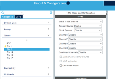

None of the other timers - including TIM3 - are not enabled as shown here:
These are the other settings:
I then generated the code.
But there is no sign of any SysTick related functions/handlers in the interrupt file stm32c0xx_it.c as you can see here:

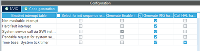

When using Systick is used as time base for the HAL, the configuration is stm32c0xx_hal.c.
So what CubeMx version are you using? and could you please share your ioc file?
2026-02-06 3:31 AM
Thank you @mƎALLEm
I just noticed that - as you can see from my original screenshot - the checkbox below was not ticked.
I have now ticked it and it generates it like in your uploaded code.
In the past I did not have to do that. So that's strange.
Did you have to tick that manually?
Thank you

2026-02-08 2:34 AM
Thank you @mƎALLEm
I dind't that why I was surprised it was not ticked. I think it might be because I enabled freeRTOS and generated the code then turned off freeeRTOS.
Thank you :smiling_face_with_smiling_eyes:
