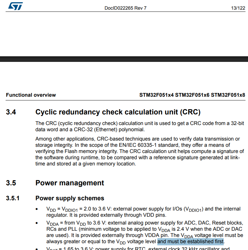

Split from: Power Supply for STM32F030 Cortex TSSOP20 VDDA and VDD pin; specifically this post.
@TDK wrote:that satisfies the condition.
But only the "VDDA >= VDD" condition - it doesn't satisfy the "VDDA must be first" condition.
As noted, I suspect that the 2nd condition is incorrectly stated; I guess it should say, "VDD must not come after VDDA" or similar ?
@TDK wrote:That is the most common configuration.
Indeed it is!
@fredy - you could check out some ST board schematics to verify ...

2025-10-30 8:14 AM
@mƎALLEm Can the misleading datasheet wording be flagged for clarification?
2025-10-30 8:25 AM - edited 2025-10-30 8:25 AM
Do you mean the statement "must be provided first" ?
2025-10-30 9:17 AM
@mƎALLEm wrote:Do you mean the statement "must be provided first" ?
Yes.
2025-10-31 2:55 AM
Hello @Andrew Neil ,
Thank you for your contribution. Reported internally for analysis and eventual fix. Internal ticket number 220882.
2025-10-31 3:23 AM
Thanks.
It also occurs in other datasheets; eg,
2025-10-31 3:41 AM
Yes unfortunately it could be spread in many other datasheets!
2025-12-11 8:18 AM
The fix will be available on the coming versions of the document.
