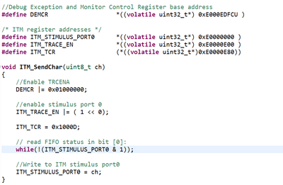

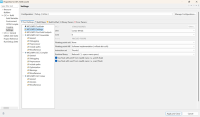

I am trying to use SWD for printing using ITM_Sendchar, Printf not calling _write, I tried to put breakpoint and see, But it is not hitting breakpoint

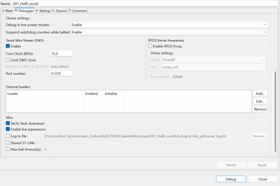

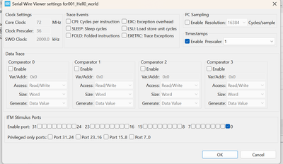

Clock speed needs to match.
Doesn't the STM32F3 have a default HSI of 8 MHz?
Use that speed.
Perhaps also output to the VCP USART so you can see in a Terminal app, and print out SystemCoreClock to confirm.

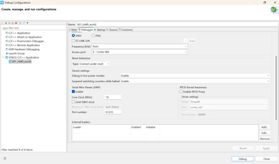

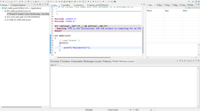

I just came here to give update, So _write is called, But now Even though I enabled SWD, and trace, and Port 0, Print is not working

Is the SWO pin configured in CubeMX?

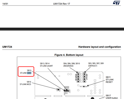

Is SB15 fitted?
via: https://www.st.com/en/evaluation-tools/nucleo-f303re.html#documentation
