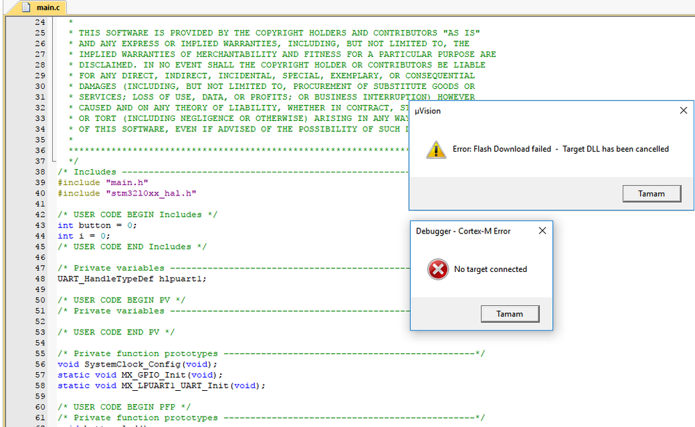

Hello to everyone. I am using Stm32f0 discovery (ST-Link) for the programmer. I will load the to external processor (STM32L011D3P6). I edited the Flash settings in Keil IDE. I get this error:
'' Debugger - Cortex M Error , No target connected ''
'' Flash Download fail ,Target DLL has been cancelled ''
Is the problem can be sourced from flash settings?
Can you help me please ? Thank you.

I've check it and problem is solved.Due to the connection error, the target processor feed was 1.5V. Now I can feed 3V. Thank you Tilen
