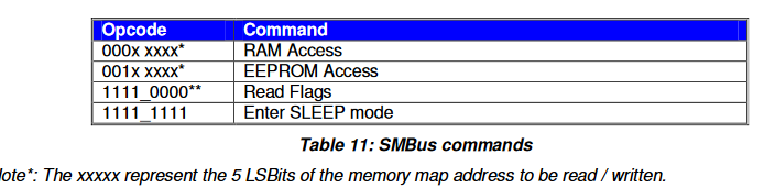

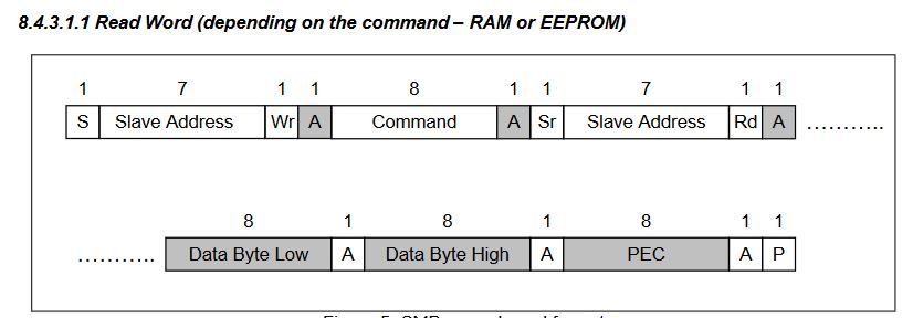

From the data sheet, follow is the algorithm
https://cloud.githubusercontent.com/assets/5645667/26305867/06c1de46-3f2c-11e7-9dad-d3fda7dce60a.png
Therefore in order to support repeat start, I see that I can use HAL_I2C_Master_Transmit/Receive_IT() API's

According to the ''From the data sheet, follow is the algorithm'' above figure,
The code is like this.
char cmd=0x07; // RAM access address 07 TOBJ
char readbuf[3]={0,0,0};// send start bit, send slave address, send write bit, send command
HAL_I2C_Master_Sequential_Transmit_IT(&hi2c2, 0x5A << 1, &cmd, 1, I2C_FIRST_FRAME);
while (HAL_I2C_GetState(&hi2c2) != HAL_I2C_STATE_READY);
//send rep start bit,send slave address, read three bytes with acks(dont care for now, about pec), and stop bit
HAL_I2C_Master_Sequential_Receive_IT(&hi2c2, 0x5A << 1, readbuf, 3, I2C_LAST_FRAME);
while (HAL_I2C_GetState(&hi2c2) != HAL_I2C_STATE_READY);�?�?�?�?�?�?�?�?�?�?�?�?�?�?�?�?�?�?�?�?�?�?�?�?�?�?�?�?�?�?�?�?�?�?�?�?�?�?�?

I am assuming internally, this API sends the data to I2c in the following form (start bit - slave address - writebit - command)
Is my understanding correct?
2017-08-04 4:36 AM
Hello.
'I am assuming internally, this API sends the data to I2c in the following form (start bit - slave address - writebit - command)' Yes it is true but it not sends a stop bit.
HAL_I2C_Master_Transmit_IT(), sends a stop bit after transaction. this is the difference.
