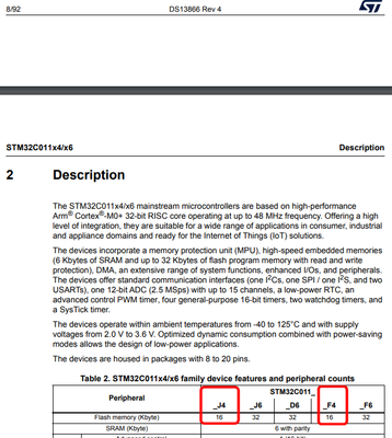

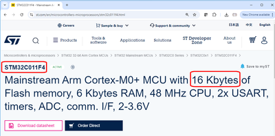

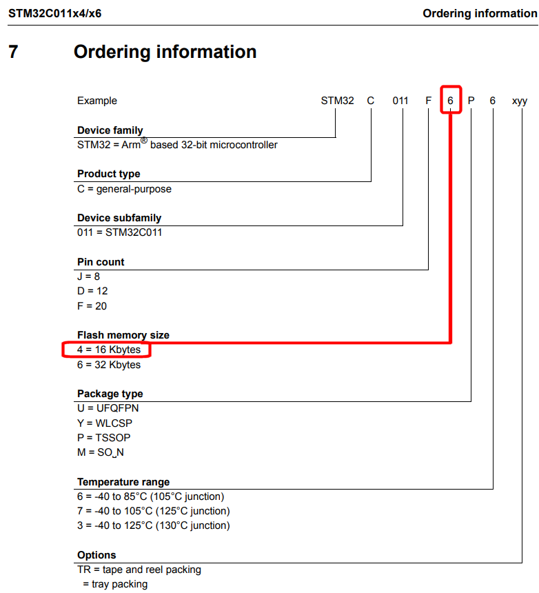

@danmcb wrote:I have some strange problems trying to access all 32kB FLASH on this chip.
STM32C011F4 only has 16K of Flash:
https://www.st.com/resource/en/datasheet/stm32c011f4.pdf

2024-09-30 4:03 AM - edited 2024-09-30 5:00 AM
