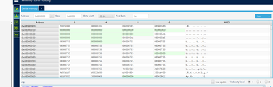

} >FLASHflash readback screen shot for boot and app:

1. The interrupts are disabled while jumping to the app. They must be enabled.
2. No need to set PSP.
3. The code may not work if compiled with the default -O0. Use -O1 or above.
4.The routine jumping to the app should be invoked in the bootloader right after reset, before initializing peripherals. It should NOT be called from ISR. See some other threads on bootloaders and app starting.
5. See the content of the file, esp. the comments:
https://github.com/gbm-ii/STM32_Inc/blob/main/cm_boot.h

2026-01-04 9:16 PM
Hi gpm,
Thanks for your timely response and the issues has been solved.
I try to modify one by one of suggestions you posted.
The root cause is "The interrupts are disabled while jumping to the app. They must be enabled".
So why the interrupts disabling make jump fail? Hopefully get your response again.
2026-01-05 1:14 AM
Your app must execute with interrupts enabled. If you disable interrupts in the bootoader, then some piece of code must enable them - either the bootloader or the app. In ARM-M architecture interrupts are enabled out of reset, so normally when you write software you assume they are enabled and don't enable them explicitly in the app.
