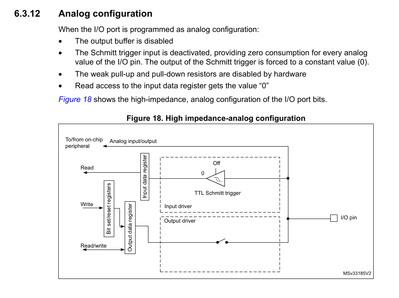

So, the things I can't understand are why:
- Why I see 165 uA of extra current if the digital frontend (Schmitt trigger) is disabled?
- Why i see the input data register of GPIOA reflecting on pin 12 the state of the input voltage if the digital frontend is disabled? The reference manual (6.3.12, figure 18) says that the input should be read as 0
Also the bits of GPIOA IDR related to other pins don't look correct if I'm not missing anything: for example PA0 is set as analog (watching the same MODER register value as before) but into the IDR it is set to 1.
Am I missing something or the pins that should be set as unconnected are somehow left with the digital input stage enabled?
