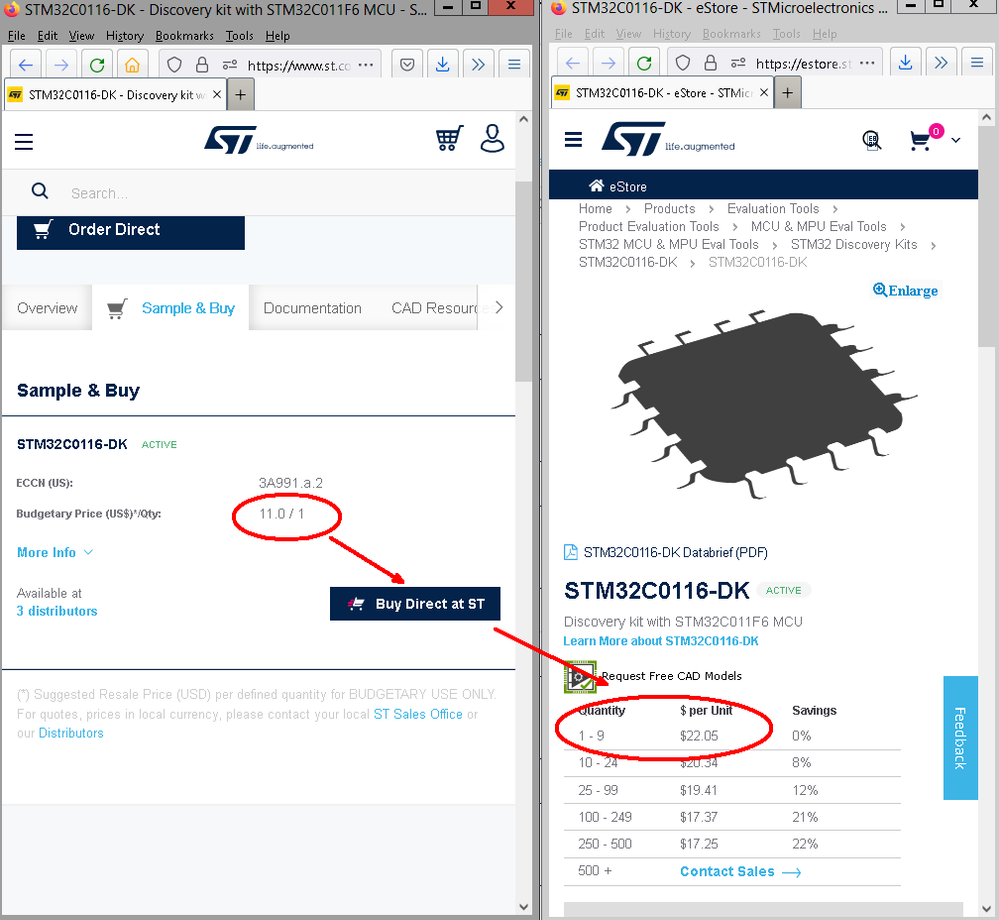

I had a look at the DISCOs. To be honest, they are lame, sorry. For example. why using proprietary LCD on the "little" one, why not a standard HD44780-compatible, with as standard pinout as possible, to maximize the chance of it working with whatever spare we have in our drawer? There's also no noteworthy perk on the "bigger" one.
The point of the DISCOs would be to make us to to do impulse purchase, play with them a little, and then put them on the shelf with the feeling of "oh now I know what this line is about". Without any such perk (or with the perk requiring me to purchase extra parts and not-that-usual headers/cables/etc), I just skip. And so will other users.
I know you hand them out at seminars and trade shows, but that's not the same thing, by far not. Buying one is an entirely different thrill and makes an entirely different impact. I understand that this all is hard to convey to the marketing folks, but I thought Discos are made by engineers. And here we arrive at this:
(* plus the hefty $30 Worldwide shipping)
which makes me even less willing to buy one, leaving a bad aftertaste instead (especially during an introductory period). (We'd need to discuss your whole "store" too, but that's for another day.)
