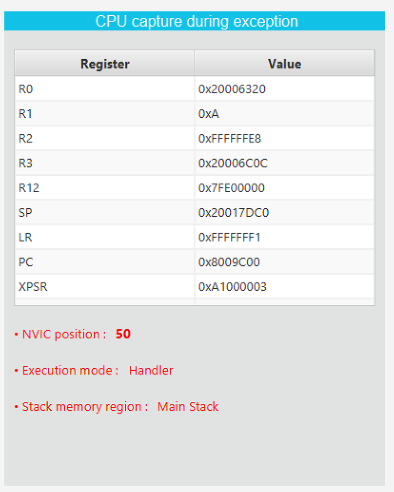

2023-03-29 9:37 AM
This is what I see in the fault analysis. Does this help?
11:35:07 : STM32CubeProgrammer Fault Analyzer
11:35:07 : Execution Mode : Handler
11:35:07 : Bus Fault detected in instruction located at 0x0800AFFE
11:35:07 : NVIC position : 50
11:35:07 : PRECISERR : a data bus error has occurred, and the PC value stacked
11:35:07 : for the exception return points to the instruction that caused the fault.
11:35:07 : BFARVALID : BusFault Address Register holds a valid fault address: 0x74636120
11:35:07 : Hard Fault detected in instruction located at 0x0800AFFE
11:35:07 : Faulty function called at this location 0x0800AFAB
11:35:07 : Hard Fault State Register information :
11:35:07 : FORCED : forced Hard Fault.
11:35:07 : Exception return information :
11:35:07 : Return to Handler mode, exception return uses non-floating-point
11:35:07 : state from the MSP and execution uses MSP after return.
2023-03-29 11:11 PM
OK so you have to look at the disasm, what instruction at 0x0800AFFE, in what function, why did it try to access address 0x74636120 (it will be in one of the registers and the offending instruction will try to ld (load) or st (store) using address from that register) and work back from there.
In other words, this is a bug in your program, and you need to debug it as usually.
