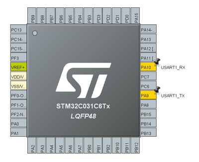

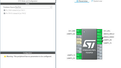

I was searching around :) in CubeMX and found the following to configure the mapping of UART1 to PA9/PA10:
First, you have to configure the remapping under System Core -> SYS.
Afterwards, you can map the UART1 peripheral to the PA9/PA10 pins.

PA12_RMP in SYSCFG must be set to remap the PA12 pin to operate as PA10 GPIO port, instead of PA12 GPIO port.
PA11_RMP in SYSCFG must be set to remap the PA11 pin to operate as PA9 GPIO port, instead of PA11 GPIO port.
