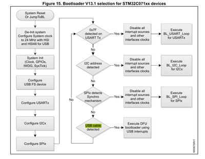

From that organigram, if USART has not received a complete 0x7F byte from the host, USB will be executed no matter which GPIO is used.

I just check your link about AN2606, I see hardware requires but still not clear about how detect between USB, UART.
Can you please point out a little bit more?

This is shown in the organigram you shared. USART has priority on USB, if 0x7F has been received it will jump to the UART bootloader otherwise the bootlaoder will be executed till USB cable detection.

@mƎALLEm wrote:This is shown in the organigram you shared. USART has priority on USB, if 0x7F has been received it will jump to the UART bootloader otherwise the bootlaoder will be executed till USB cable detection.
The main thing here is, how do we detect USB cable plug while PA9, PA10 are used for UART?
USB still work even PA9 and PA10 are used for UART?
2024-12-03 12:00 PM

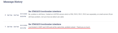

No, problem is still there, I tested on LQFP64 version which is PA9, PA10, PA11, PA12 are separately, on small version 28 pin still have problem, not sure how we detect usb cable.
2024-12-03 12:59 PM
No, problem is still there, I tested on LQFP64 version which is PA9, PA10, PA11, PA12 are separately, on small version 28 pins still have problem, not sure how we detect usb cable.
2024-12-03 1:09 PM
Why you edited your post you've already confirmed it's working:
I suppose that thread is closed. Please open an new thread.
