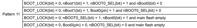

I think the BOOT0 pin is ignored by default on the STM32C0. Change the option bytes in STM32CubeProgrammer if you want to change this behavior. See AN2606 for details on entering the user manual. See the STM32C0 Reference Manual for details on the factory settings for option bytes.

Thank you for your assistance,
I was able to solve my UART flashing issue — the problem was the nBOOT0 option bit. After unchecking nBOOT0 in STM32CubeProgrammer, I could connect and flash using UART successfully. Thanks a lot for the support!
