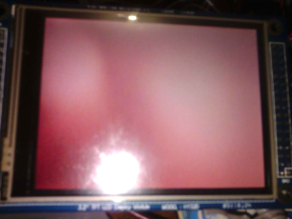

after I put 10K pull up, I got response, but I haven't seen a proper picture,
only dot dot red green blue cyan, but when I moved the sensor (ov7670) the LCD was moving as well.... Update, the display has displayed picture completely but very slow.....is it because of the 12MHz on OV7670 or I2C clock is too slow ? Does anyone have experience ?thanks2014-04-08 6:25 AM

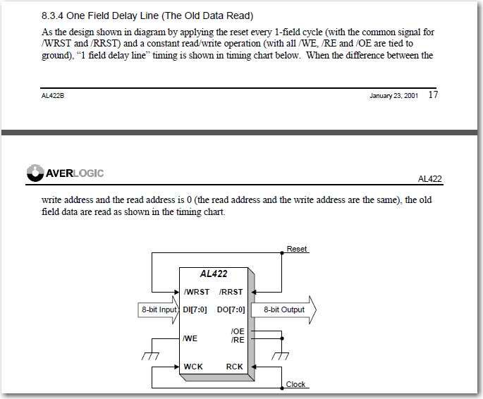

The FIFO is rated up to 50 MHz The OV7670 from 10 to 48 MHz What clock is you camera generating, or what clock are you passing to it? Are you generating a clock via the MCO pin PA8? Do you have a manual or data-sheet for your camera board/module?2014-04-08 5:14 PM
DCMI is the Digital Camera Interface on the F4 parts, it's a very high speed parallel interface. As I recall up to 50 MHz
The F1 doesn't have one, so you are either using DMA or manual GPIO toggling/reading, the latter will be rather slow.2014-04-08 5:24 PM
Last progress :
2014-04-08 5:25 PM
