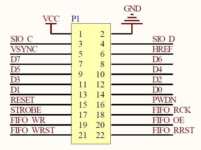

I have OV7670 module and STM32 dev board, I'm confused on how to connect the port of STM32 and OV7670 at the module because of the name of the port on OV7670 is different with in STM32 code, anyone has experience ? thanks

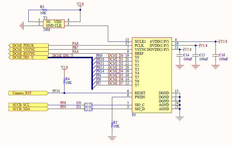

This is from one of the boards I've looked at supporting the OV7670

yes there's AL4228 in between STM32 and OV7670...are the pin connections the same ?
Clearly they are not. It would help significantly if you reviewed the part documentation. How does it work with the FIFO, I don't know, but the Camera itself is compatible with the DCMI peripheral, so the point of the FIFO is what? The purpose of having a FIFO is to mitigate the interfacing of the camera to a micro without a DCMI peripheral. A direct connection of thehttp://www.voti.nl/docs/OV7670.pdf
is consistent with the F407 schematic I provided earlier. As you're using an F10x part you'll need to make an assessment for that.2014-04-07 11:13 PM
The purpose of the
http://www.frc.ri.cmu.edu/projects/buzzard/mve/HWSpecs-1/Documentation/AL422B_Data_Sheets.pdf
is to act as a frame grabber. You still need to generate video timing signals for the camera (clocks, horizontal, and vertical timing), and reset/initialize the FIFO, using GPIO pins. The FIFO would attach to an FSMC type external bus arrangement, allowing you to extract the frame.2014-04-08 2:56 AM
Module Pin Name | Description | STM32 end pin connections |
SCCB_SCL: SCCB clock: PB10 I2C2_SCL
SCCB_SDA: SCCB data: PB11 I2C2_SDA
CAM_VSYNC: Frame Sync: PA0 external interrupt 0
CAM_HREF: FIFO: PB7 GPIO
CAM_WEN: FIFO write enable: PD3 GPIO =WR ?
XCLK: CMOS sensor master clock: PA8 MCO output
CAM_RRST: FIFO read address reset: PE0 GPIO
CAM_REN: FIFO Chip Select: PD6 GPIO =OE ?
CAM_RCLK: FIFO read clock: PE1 GPIO
FIFO D0 ~ D7: FIFO data output: PC0 ~ PC7 GPIO
I saw some pins unconnected because I can't find in the code :
STR, RST, WRST,PWDN
and is it equivalent ?
At OV module
CAMREN: FIFO Chip Select: PD6 GPIO =OE ?
