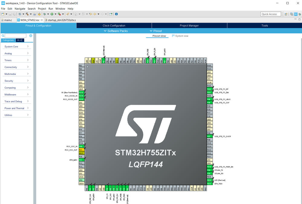

Hi , the probnlem was that I forgot to assign SPI_CS pin to the m7 Core inside the CubeMX .
