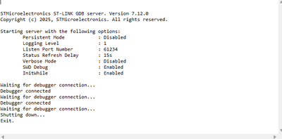

I am trying to build the basic LED Blink on the STM32-N6570-DK , since i have build the code and try to run with the default settings it ends up with the following problem , whats the reason and how to solve this ?

Hello @MownishBugatha
Let me thank you for posting.
I am able to debug STM32-N6570-DK using STM32CubeIDE 2.0.
I recommend that you take a look this Application Note.
It describes how to get started with projects based on STM32N6 microcontrollers in the STMicroelectronics
STM32CubeIDE integrated development environment.
I suggest also that you connect the board with STM32CubeProgrammer and erase the Memory, before launching the Debug Session.

2026-01-28 2:54 AM
still the issue has been same even following the same steps , the issue hasn't resolved ? is there any alternative to check why it has been occur and rectify the solution
I want to know please, if you are able to connect the board with STM32CubeProgrammer.
Thanks.
Mahmoud
2026-01-29 1:32 AM
Yes
