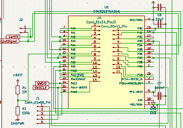

After receiving our first PCBs, we were unable to successfully program them with the stlinkv3 minie. Attached is an image of the schematic of where the STM lies on the board as well as the attached components. When the boards first came in the stm32 was able to be flashed with a program, but after the first flash they could not be connected to any more. This is with using an external power supply as the stlink v3 didn't seem to provide power as the prg tool was unable to detect the chip.

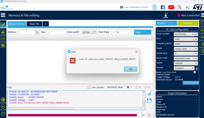

After continued testing (and changing out the mcu) the issue persisted although with a slight deviation, it would allow us to program it once or twice but when we clear the flash, it would lose connection and throw an error of dev_target_held_under_reset. In case it is relevant, the only connection type that can even read the flash of the chip is hot plug but that is unable to change the data as far as I am aware.

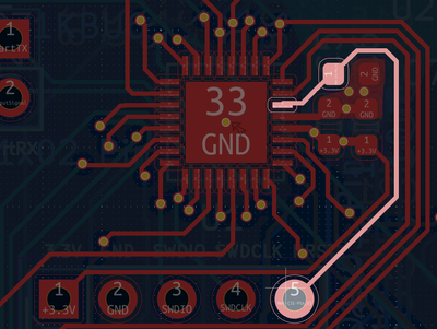

This is very frustrating as we have not been able to even test the hardware that we have designed for the past 2 months as we have been stuck trying to program the boards for so long. Any help or solutions that could be provided would be absolutely lovely. The layout of the microcontroller for one of the PCBs is also provided with the reset path highlighted. (Continuity of all of the paths has already been tested and there are no issues in that respect.

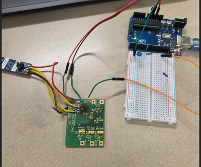

Is there a common ground between the board, the programmer, and the power supply? Show a picture of this.
Does the programmer report the correct target board voltage? Show a full screenshot when you try to connect.

Yes, All three grounds are connected, im currently out of the lab and using an arduino as a power supply, not the most elegant solution, but it is what i used when programming the nucleo board. If you think its because of the arduino... I can go to the lab in about 45 minutes and send a screenshot from there, but the voltage on 3.3v is 3.3v, and the arduino can deliver more current than the mcu should take.

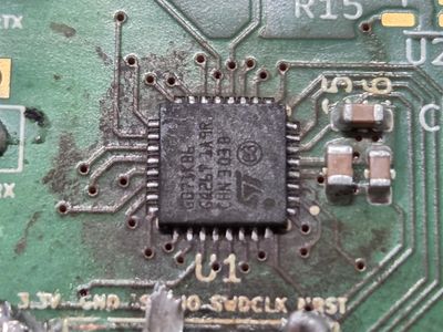

Also, the black around the microcontroller is from the flux that we used, it was old and discolored the soldermask.
2026-02-02 11:54 AM
This is likely a hardware issue. If NRST is stuck low, the chip may not have sufficient power. There's nothing wrong with this setup in theory.

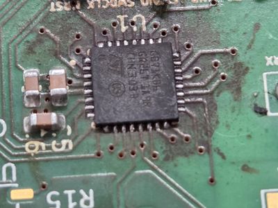

Is the chip oriented correctly? That picture isn't close enough to tell. Pin 1 is bottom left when text reads from left to right. If you can, post a clear, large, in-focus of the chip itself and surrounding solder joints.
Turn your soldering iron down. The flux should not be discoloring that much, even if it's old.

It looks a bit like BBQ, sorry.
Maybe it got damaged while soldering?
2026-02-02 12:05 PM - edited 2026-02-02 12:06 PM
While that is possible, the same problem has happened with multiple chips. The ic was installed with hot air gun set to 400f, this issue has persisted across 4 different stm32s that are across different pcbs, though ive used 2 on this pcb.

Orientation looks correct.
Capacitor solder joints look good.
Presumably the STM32 solder joints are okay too. Looks better than I was expecting from the first picture.
400 F is a good temp for leaded solder. The capacitor joints look good so the temperature is probably good even if the "400" setting is off.

The schematic is good, this isn't a design issue.
