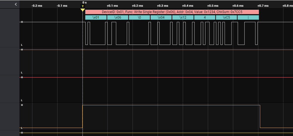

Serial analyzer:

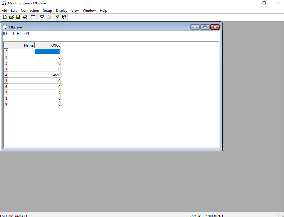

Modbus slave simulator:
As you can see from above, the value on the modbus simulator has been updated to 4660 when I have executed the command so everything seems to be working fine.

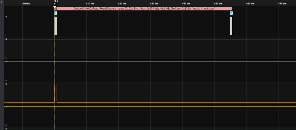

The serial analyzer output:
As you can see from above, the serial analyzer picked up signal and received a response after 50ms.

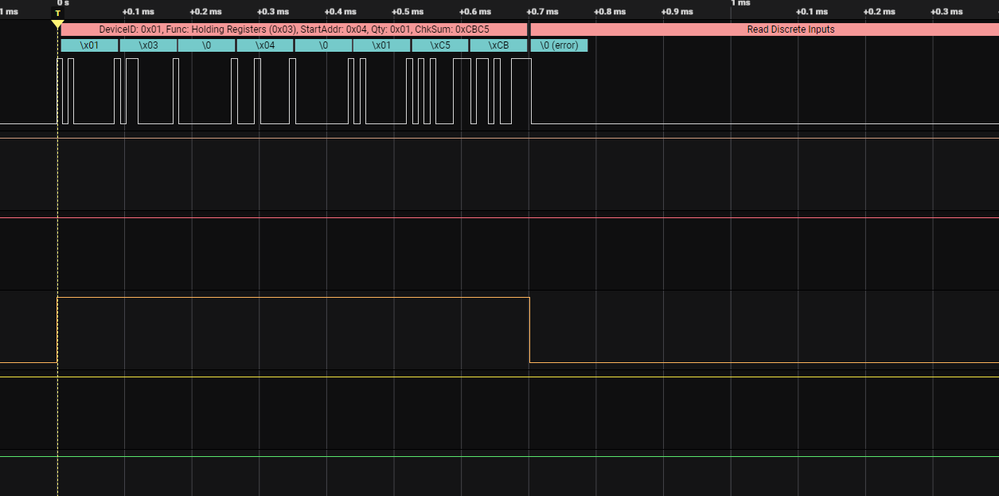

If I zoom in to modbus request to read register:

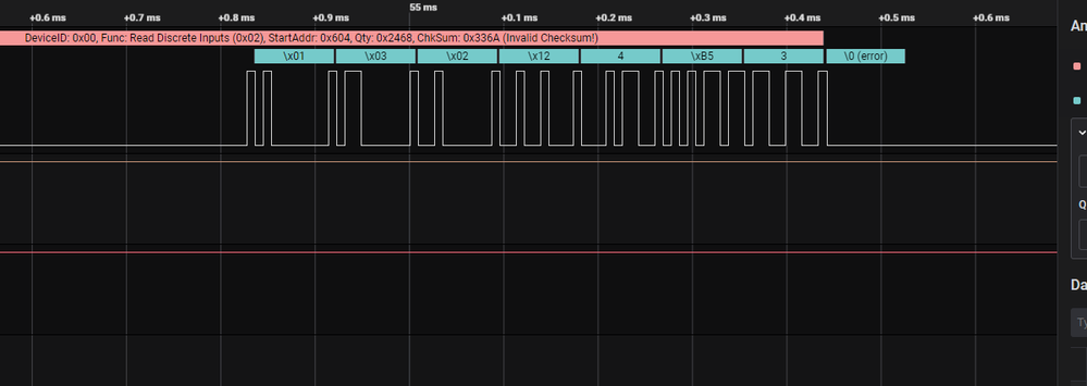

This is modbus response 50ms after the request:
The response does not seem to be correct. I would like to understanding what is happening here and what could be the issue. I would appreciate a lot if someone could help me out here thanks in advance.
