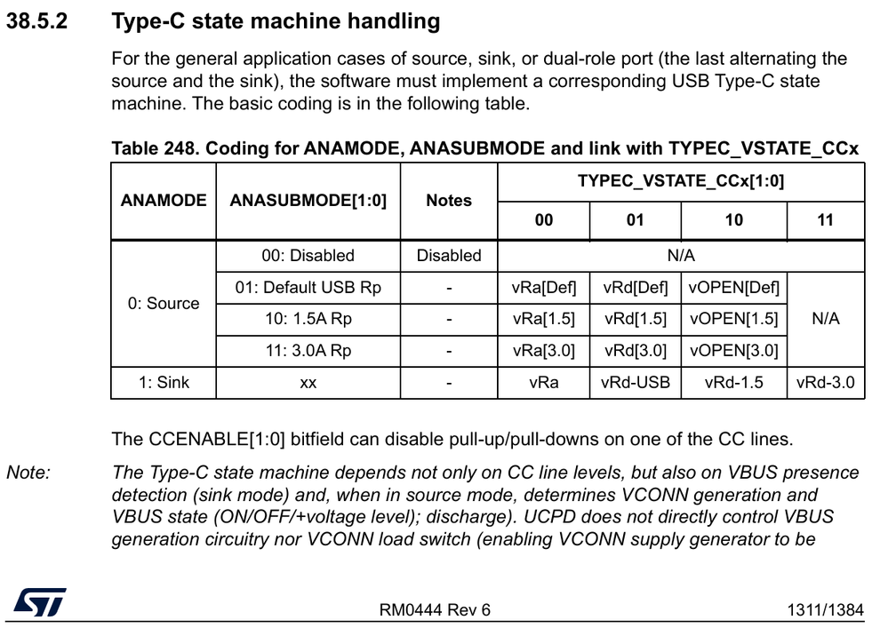

Hi @JamesC
If the CC analog function is disabled via ANASUBMODE being disabled, the remaining observation of the line can only be done through an external sensing method such as ADC based polling. This is a workaround, not a supported silent Type-C / EMarker operating mode.
