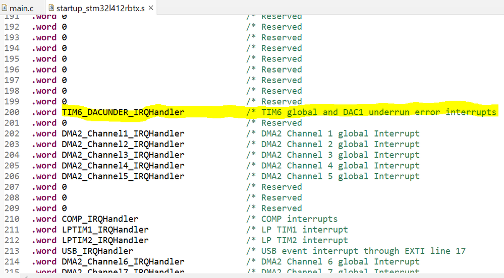

Thanks @KnarfB as you said IRQ handler was different the actual one is TIM6_DACUNDER_IRQHandler. After I changed the handler name the code started working

Glad it works. To add some confusion: stm32l412xx.h (ARM CMSIS) and others contains a line
/* Aliases for __IRQHandler */
#define TIM6_IRQHandler                TIM6_DAC_IRQHandler
which covers that error up. But you don't seem to use that.
I've never seen handler name like this. As I've said above, I would like to know where that startup_stm32l412rbtx.s is from.
when I tried the debug mode startup_stm32l412rbtx.s was autoloading because of the error, it was in the debug folder under projectname.elf -[arm/le]. I got the Handler name from this file.
What toolchain / version are you using?
